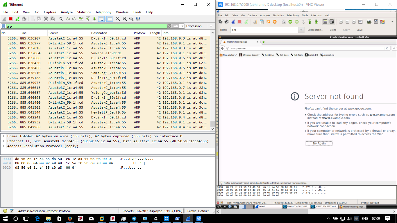

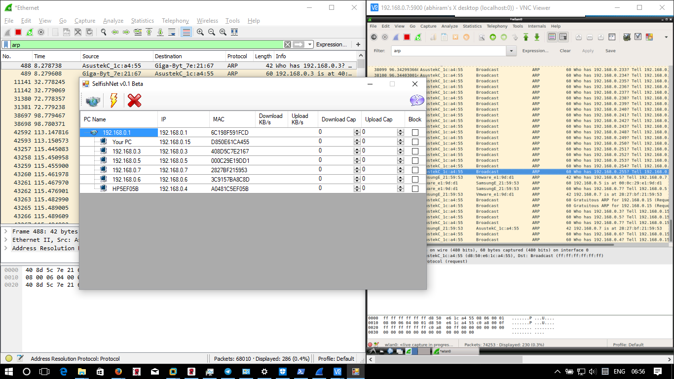

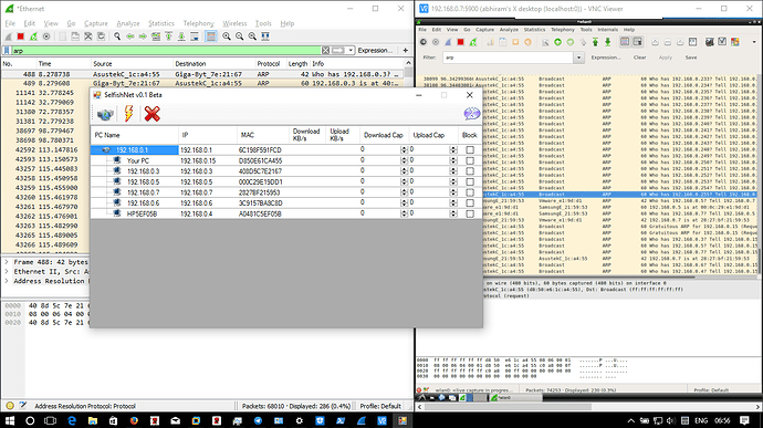

See all the arp pings in the background. Btw on the left its my laptop, on the right is my android phone running kali
Now im going to block my android phone.

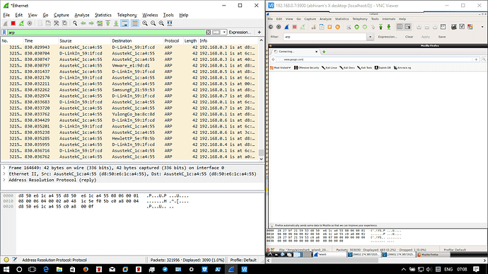

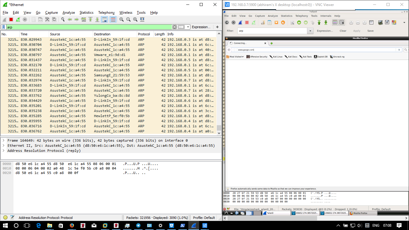

Here my laptop ASUS banded is telling my oneplus(idk why it shows up as samsung) its 192.168.0.1 and wireshark was intellegent enough to detect it.

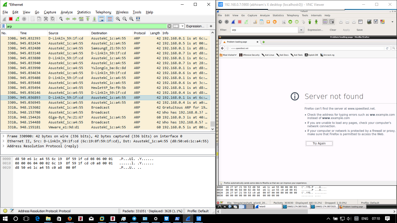

Now I try browsing internet on my phone.

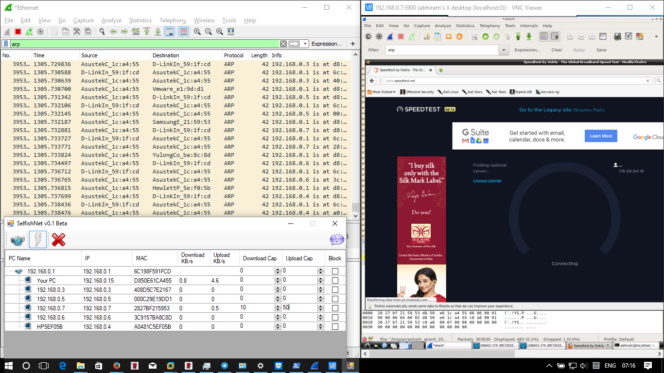

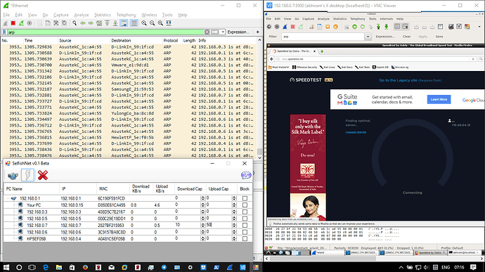

As u can see i cant access my internet. Now i try to limit instead of blocking
As you can see test is not even starting because of bandwidth limitation. On the left u can see that the speed of sending ARP poison messages has decreased.

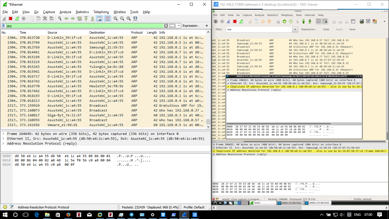

See my laptop doing a MITM attack.
